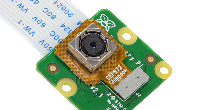

  1. The V1 and V2 have sealed the lens assembly and the image sensor in one package, then connected to the camera PCB with a board-to-board (BTB) connector. This design is also known as Compact Camera Modules (CCM), and it’s the kind used in smartphones.

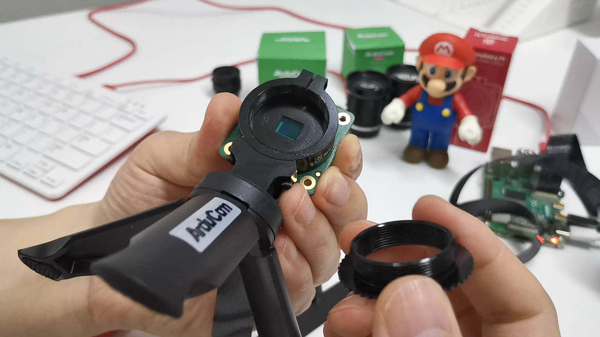

  2. The HQ camera has a dedicated lens mount. Instead of having the image sensor in one package as the lens assembly, the IMX477 image sensor of the HQ camera is on the camera PCB.

The detachable compact camera module on Raspberry Pi Camera Module V2

  1. We build a CCM with a focus motor inside, and then connect it to the Raspberry Pi Camera PCB.
  2. We build a special lens assembly with a focus motor and mount it above the image sensor onboard.

CCM Autofocus replacement on the official V2 Camera Board

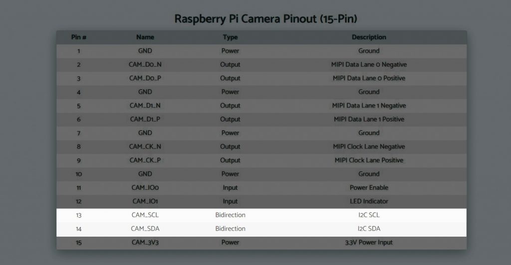

From above, we know that the key physical connection is the MIPI CSI camera ribbon cable. If so, do we have anything on the MIPI CSI connection that can help us control the motor?
I2C bus. More specifically, the I2C for the VideoCore processor.
i2c_vc
Set to “on” to enable the i2c interface, usually reserved for the VideoCore processor (default “off”).
raspberry pi camera pinout i2c
I2C in raspberry pi camera pinout, useful for controlling the focus motor
So, we use the i2c_vc to control the motor. What we need to do is to add the following line to the /boot/config.txt.
