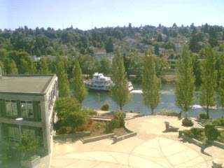

An image taken with the OV2640 out an office window at Google Seattle.
The first iteration of my code simply took a picture, then waited a minute using delay before taking another, repeating until the camera ran out of battery.  This managed to take 364 bitmap images until it ran out of juice.  Thesecond iteration of my code made use of the Sleep_n0m1 library to place the Arduino in sleep mode and wake it up each minute.  I had hoped that this would improve battery life substantially, but instead it managed only to take 370 images before running out of battery.
