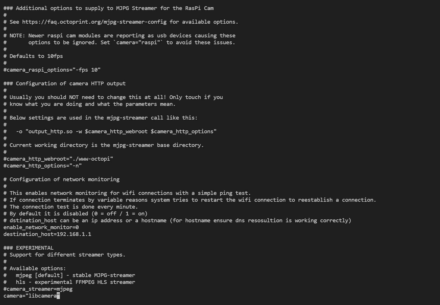

5. Modify the octopi.txt file
Edit /boot/octopi.txt, and make the following changes
5.1. Configure which camera to use
image 15
like this:

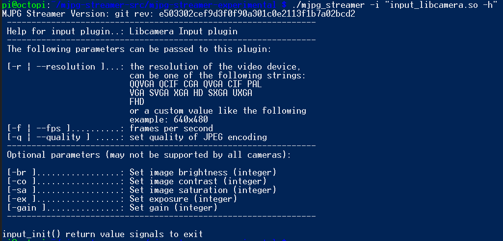

5.2. Set parameters for libcamera plugin.
camera_libcamera_options=""
Parameter details can be viewed using the following command.
./mjpg_streamer -i "input_libcamera.so -h"

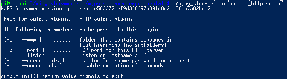

5.3. Configuration of camera HTTP output
camera_http_webroot="./www"
camera_http_options=""
You can also use the command to view the camera_http_options parameter.
./mjpg_streamer -o "output_http.so -h"

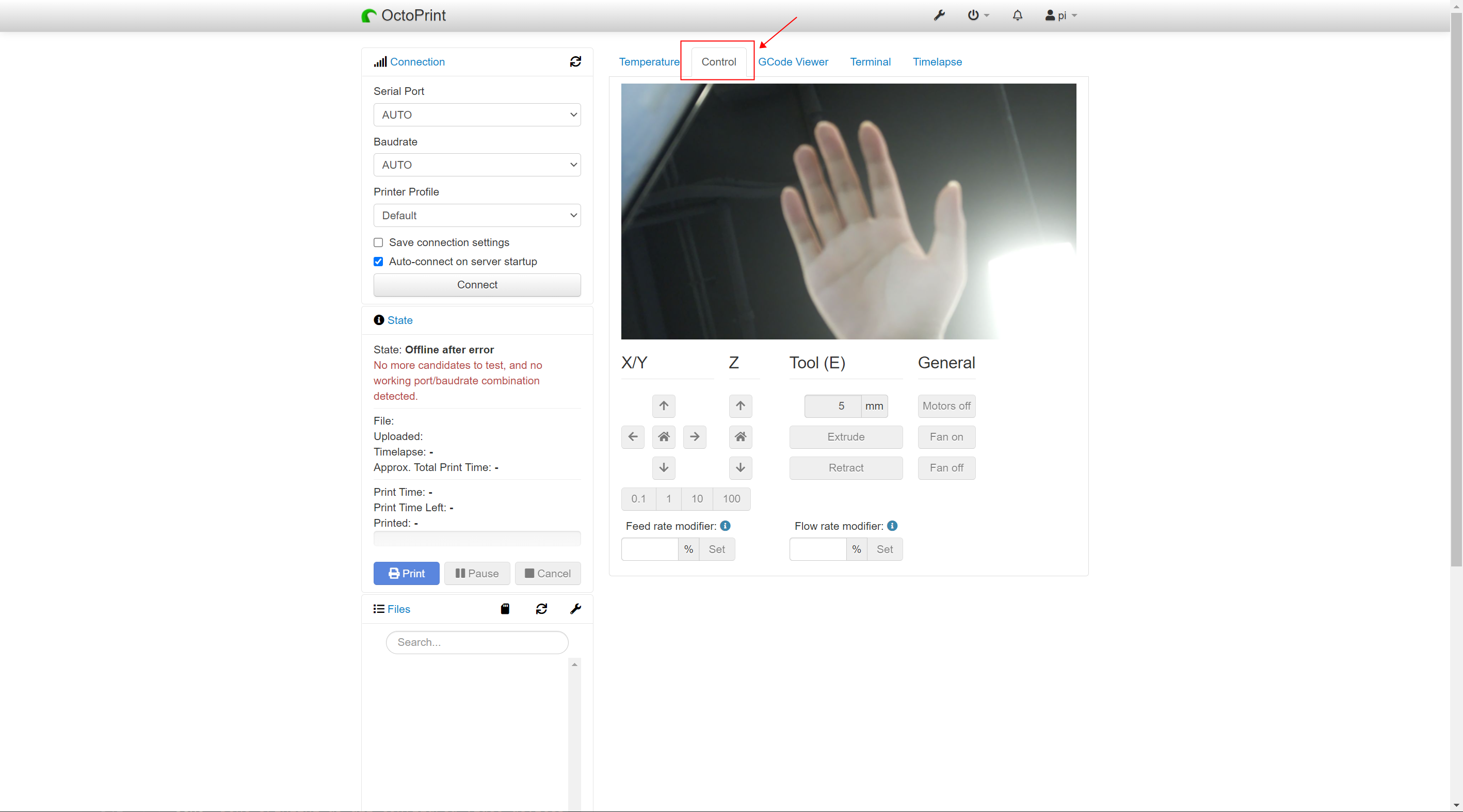

8. View in browser
8.1. Display
Enter the device’s IP address(ipv4 address) in the browser address bar.
Click on the label pointed by the red arrow in the image below to view the image captured by the camera.

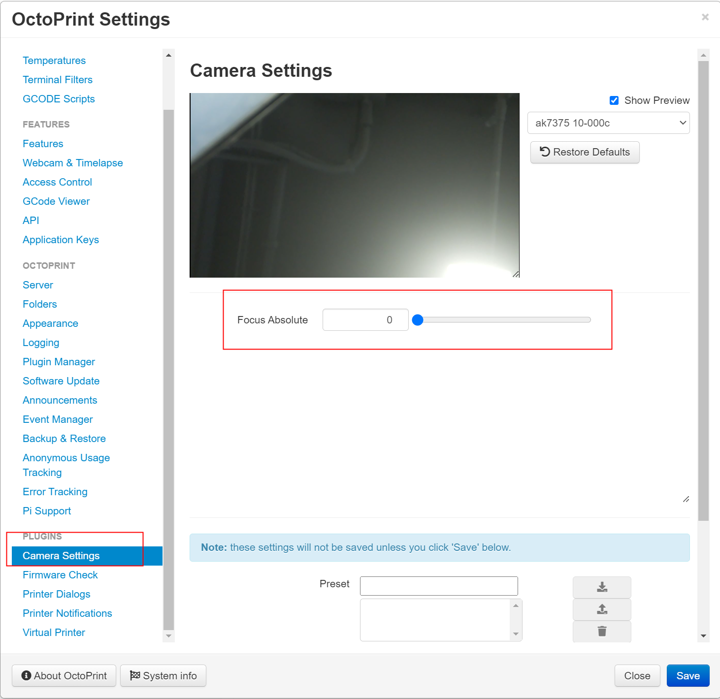

8.2. Control

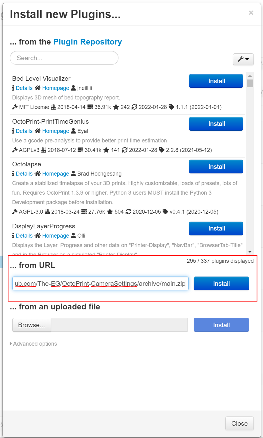

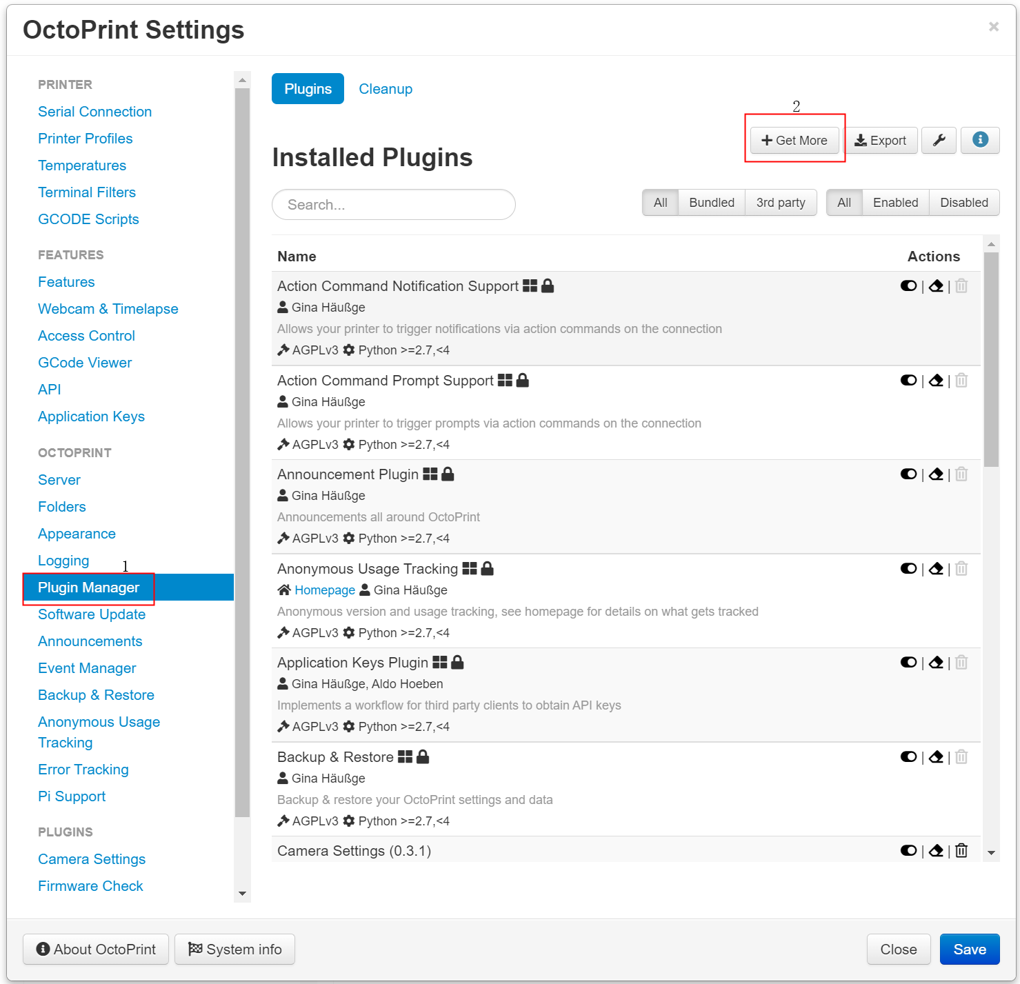

Install control plugin
Click the button pointed by the arrow in the image below.
Follow the instructions to complete the plugin download.
Copy the link to the location outlined in the diagram.
https://github.com/The-EG/OctoPrint-CameraSettings/archive/main.zip
Finally, follow the prompts on the page to restart the service.
sudo reboot
You can use this plugin to achieve manual focus.
